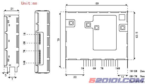

VMN1212501A是一个电视用解调器,用于CT-2970B电视机,输出音,视频。
The VMN1212501A is a demodulator,used in the CT-2907B TV,video and audio output.
