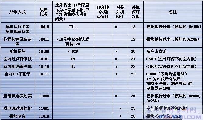

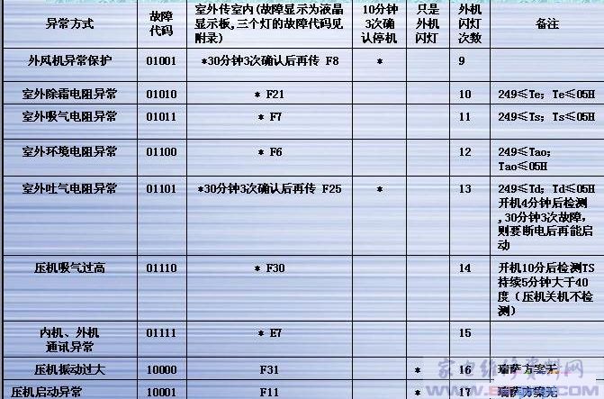

海尔KFR-28GW/01B(R2DBPQXF)-S1空调室外机故障代码
