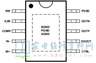

二、HT8731引脚功能
| 管脚 | 引脚名 | 引脚说明 |
| EP | BGND | Ground for boost converter circuitry. 升压电路地 |
| EP | AGND | Ground for analog circuitry. 模拟电路地 |
| EP | PGND | Ground for power circuitry. 功率电路地 |
| 1 | SW | Boost and rectifying switch input. 升压整流开关输入端 |
| 2 | ILIM | Adjustable switch peak current limit. An external resistor should be connected between this pin and GND.最大限流值设置端,外部接电阻到地。 |
| 3 | COMP | Output of the internal error amplifier, the loop compensation network should be connected between this pin and the PVDD pin. 环路补偿脚,接补偿电路到PVDD。 |
| 4 | IN- | Negative input (differential-) for audio amplifier. 输入正端 |
| 5 | IN+ | Positive input (differential+) for audio amplifier. 输入负端 |
| 6 | CTRL | Mode Control Terminal. 模式控制脚 |
| 7 | EAOUT | Error amplifier output. Connect a 3.3nF capacitor to GND typically. 误差放大器输出端,接3.3nF典型值到地 |
| 8 | OUTP | Positive pin for differential speaker amplifier. 输出正端 |
| 9 | OUTN | Negative pin for differential speaker amplifier. 输出负端 |
| 10 | PVDD | Power Supply for internal power circuitry. 功率电源 |

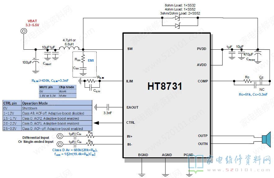

三、HT8731典型应用电路

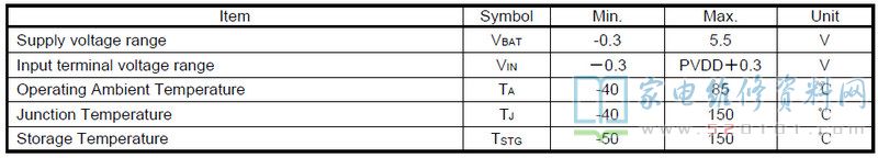

四、HT8731极限电气参数
