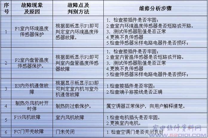

海尔KFR-60LW/01B(R2DBPQXFC)-S1空调故障代码
